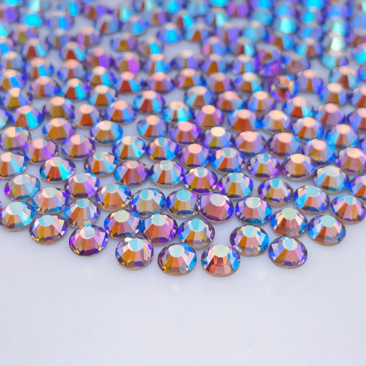

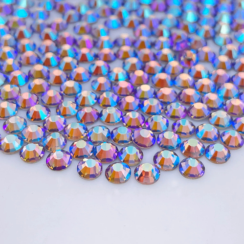

Hello fellow Keyshooters,
Does anybody knows how to create this kinda rainbowish rhinestone material? I tried with gemstone material, dialectric with a iridescent gradient map, but could not get any results near to something like this.
Maybe you can try to use materials from the ‘Multi Layer Optics’ category. Tweaking the values will give you different color effects.
Would probably get close using a dielectric material as the base. Then color gradient (rainbow) set to view direction. Turn off blend to get a different color on each facet. I think that’d get pretty close.
